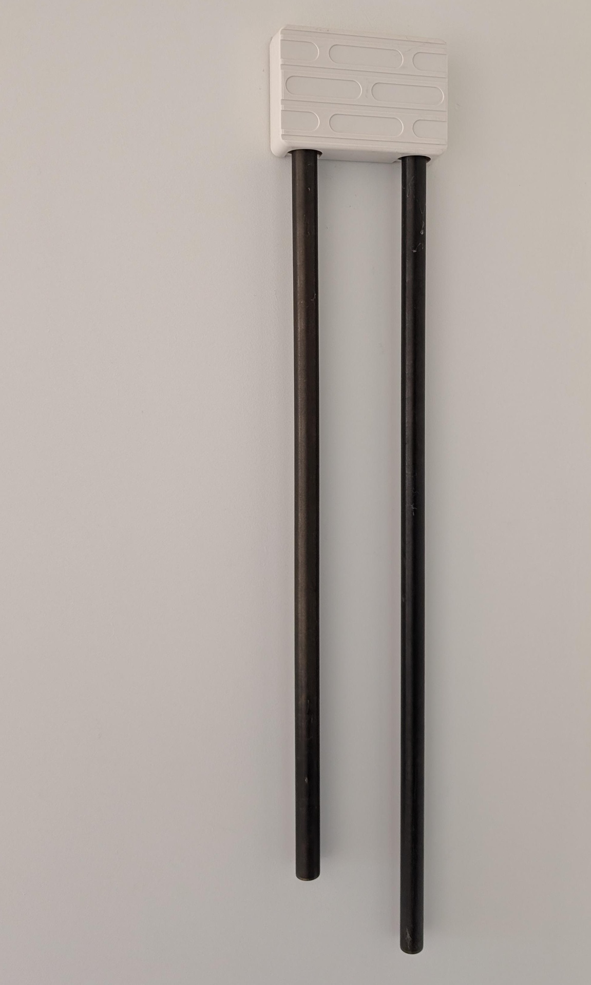

Smartify your doorbell
I have a regular old fashion “ding-dong” doorbell, but what is the fun of that?
Not smart doorbell
