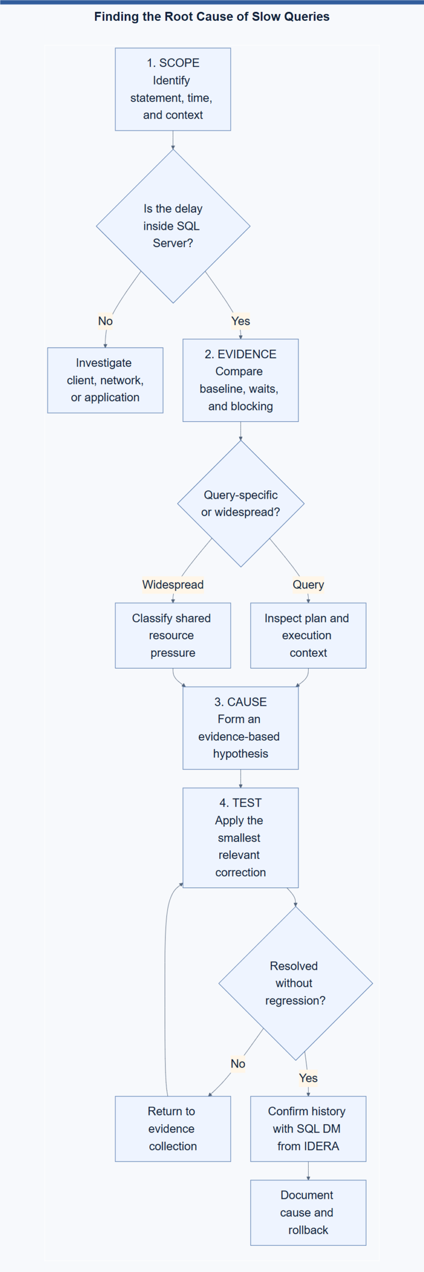

Make the First Split
A practical troubleshooting method separates running from waiting. Compare elapsed time with worker time for the request. Similar values usually indicate active processing, while a large gap means substantial waiting.
That first split does not solve the incident. It eliminates classes of wrong fixes before they reach the production server.

Identify the Exact Statement
Start with the statement that users experience, not a similar batch copied from documentation. Capture its database, application, login, parameters, query hash, plan hash, and execution context. Those details separate one expensive pattern from thousands of harmless executions.
Query text alone can mislead. Different literals may trigger different cardinality estimates and plans. Session settings can also change plan selection. A normalized query signature groups related statements, while individual executions expose parameter-sensitive behavior.
Read the Actual Plan as Evidence
An estimated plan describes what the optimizer expected. An actual execution plan adds row counts and warnings. Compare estimated rows with actual rows at each operator. Large differences can expose stale statistics, skewed data, or parameter sensitivity.
Look for spills, excessive lookup repetitions, oversized memory grants, and unexpected scans. A scan is not automatically wrong, and a seek is not automatically efficient. Context decides whether an operator is expensive. The percentage printed on a plan is an estimate, not measured elapsed time.
Do not rerun a costly production statement to obtain an actual plan. Use a captured plan when possible, or reproduce the workload safely elsewhere. Evidence collection should not create a second incident.

Turn Evidence into a Decision
SQL DM from IDERA brings live metrics, query details, alerts, and historical context into one investigation path. The value is keeping enough context to test competing explanations quickly and safely.
Good diagnosis ends with a claim somebody could prove wrong. Name the resource, query, plan change, or transaction responsible. Record the supporting metrics and the expected result of the fix. Then measure again under comparable conditions.
