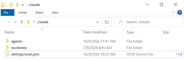

Air can create a new branch and Git worktree for a session in one click. A worktree gives each pull request its own branch and working copy, ensuring that changes from one session won’t affect any other sessions.
To run sessions in parallel:
Start a new session. Above the message box, click Local and select New Local Worktree.
Select your preset by clicking the agent selector below the prompt box, then paste the pull request link.
Repeat for each pull request you want to work on.
RustRover opens each worktree in a new window, so you can treat each window as a workspace for one task. The Agent Sessions tool window marks each session as in progress, waiting for your input, or finished with results you haven’t opened yet.
